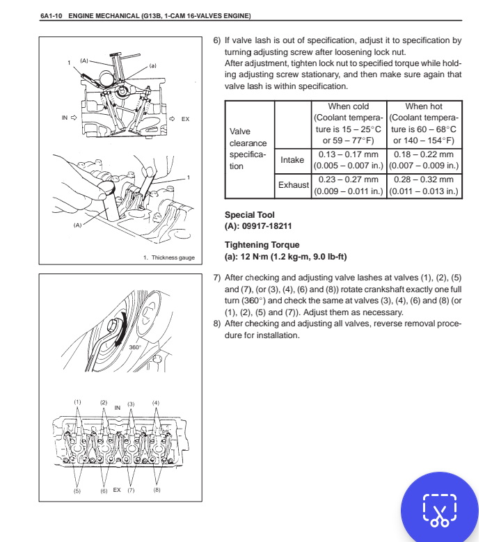

AOA All, i am quite late on the post but, here is something for all those would search this post and find helpful. So the standard setting for tappet is
As per the manual instructions attached. See the instructions and then try doing it yourself. Honestly speaking, i cursed all the mechanics whou would go cylinder by cylinder. The manual has tons of info aval, you can find it online. If u dont find it, search for G13BB engine, they are the same 16 valve. Good luckUploading...
