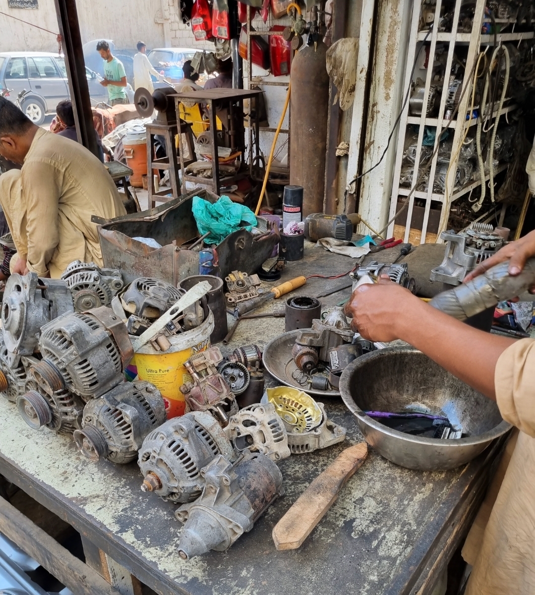

Visited Fareed Electrician based on @capsat recommendation. They didn't do anything except take the alternator out and have me visit another shop in Magazine lane:
They determined my "kataut" was faulty and replaced it. Tested it using a motor that spun the alternator and showed 14V unloaded. When I asked them about why they don't measure loaded voltage, they gave me the usual - "tajurba," "saalon se kar rahay hain," "befikar rahain," etc.
An ammeter and a few cheap lights in series would have done the job, but not having it gives them plausible deniability for their crappy junkyard alternators.
